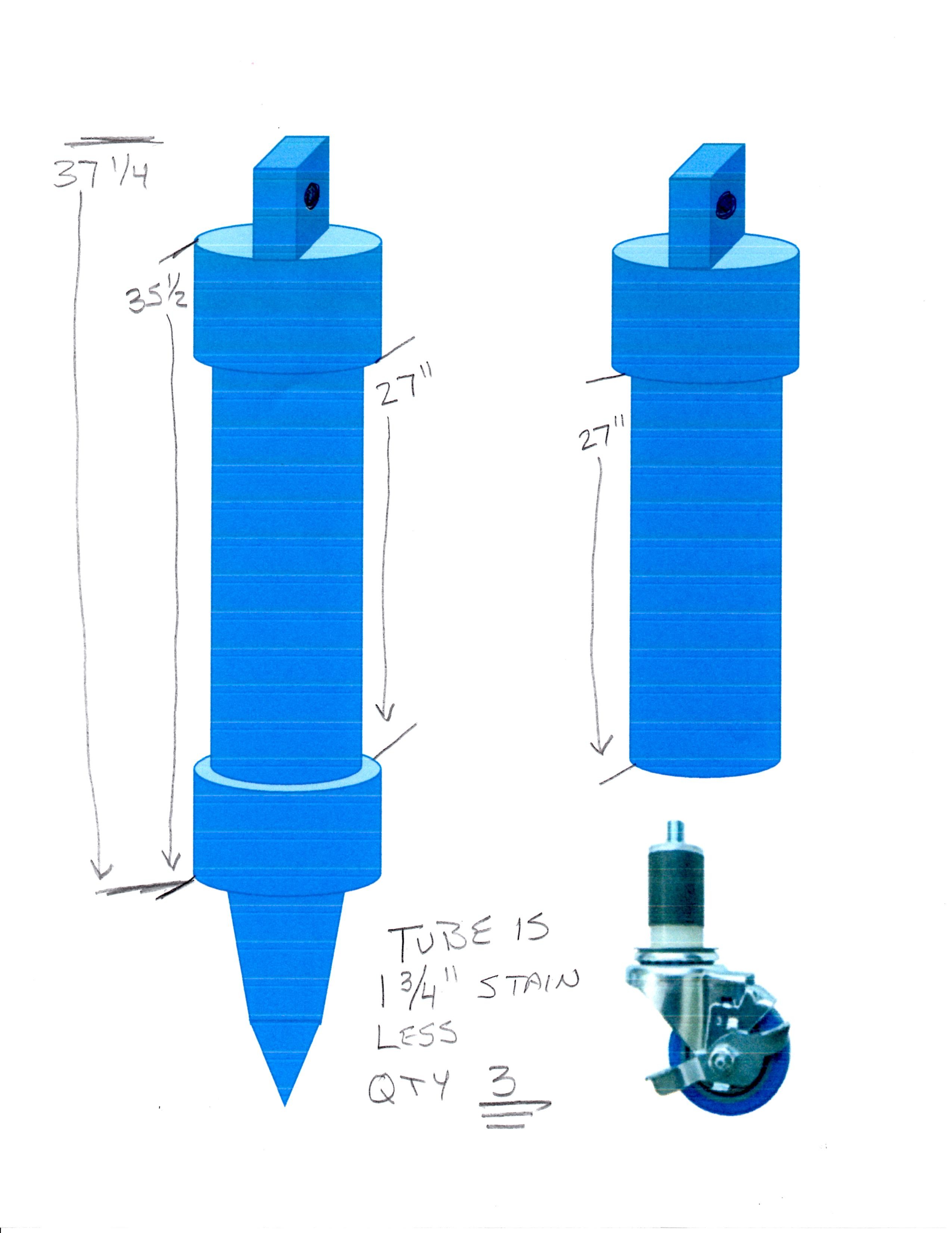

Ok   here is my situation.  I am wheelchair dependent and have recently purchased my first telescope.  I purchased new a Orion SkyView Pro 8" Equatorial Reflector Telescope.  I have looked to see how others with my condition enjoy using reflector type telescopes.
My telescope arrived and I immediately realized that I will need a dolly mechanism to move that around my patio area.  I looked for a model specific dolly and found nothing.  I looked for a universal rig and found they were all about 400.00.  Here is what I looked at as my best answer.  Remove the toes from the bottom of the tripod legs and install rolling/lockable casters.  I found a set of 3 casters delivered to me for about 60.00.  I then found the toes are epoxy glued to the stainless steel legs.  It appears I will need to cut off the toes to do what I am thinking.  The attached picture hopefully explains my idea.
Does anyone have a set of Orion SkyView Pro 8" Equatorial Reflector Telescope tripod legs (only) for sale?    I am in Jacksonville FL.   I am also open to other ideas as to options.  Thanks in advance.
AL
Big_Al_in_Jax_FL's attachment for post 183526

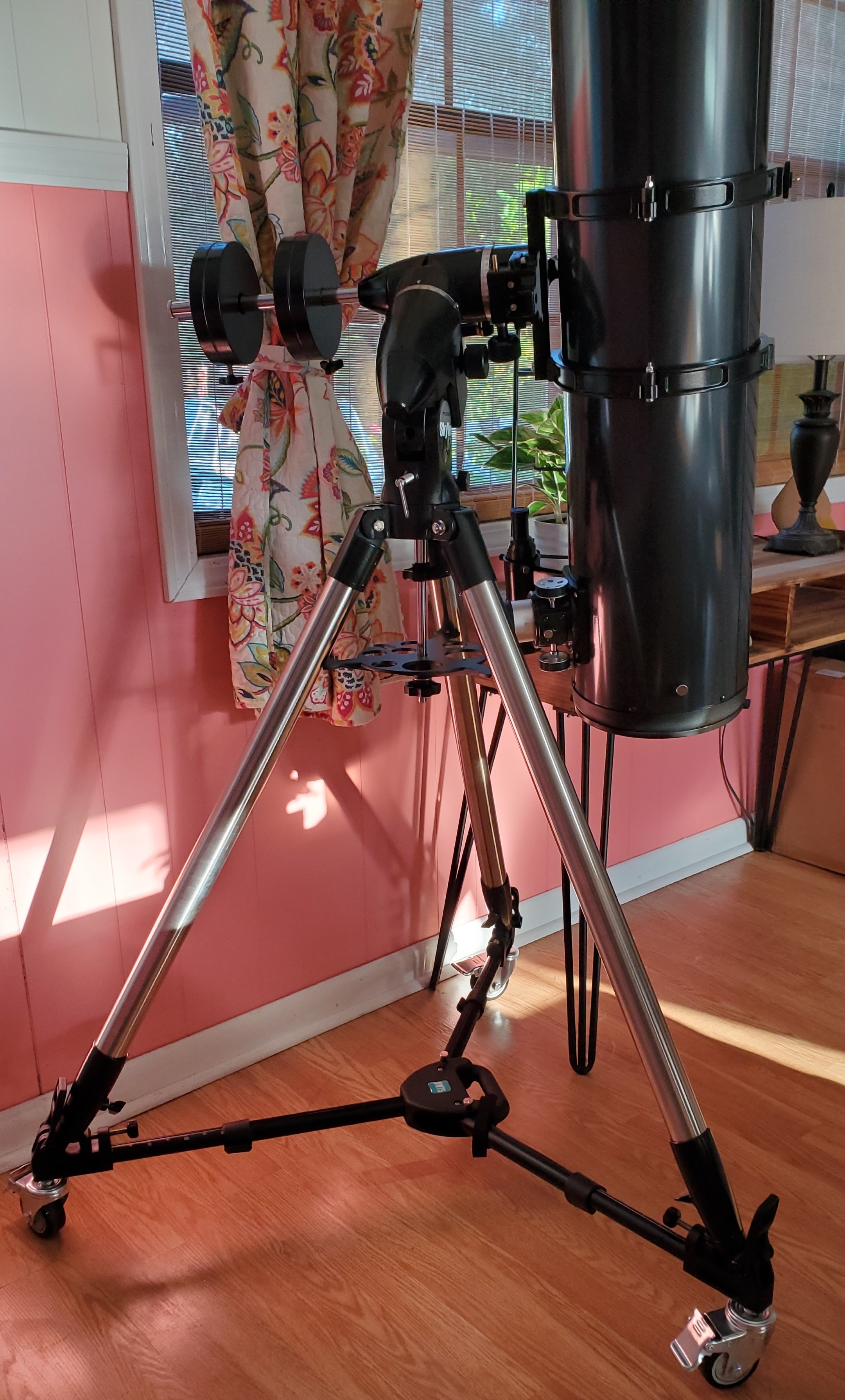

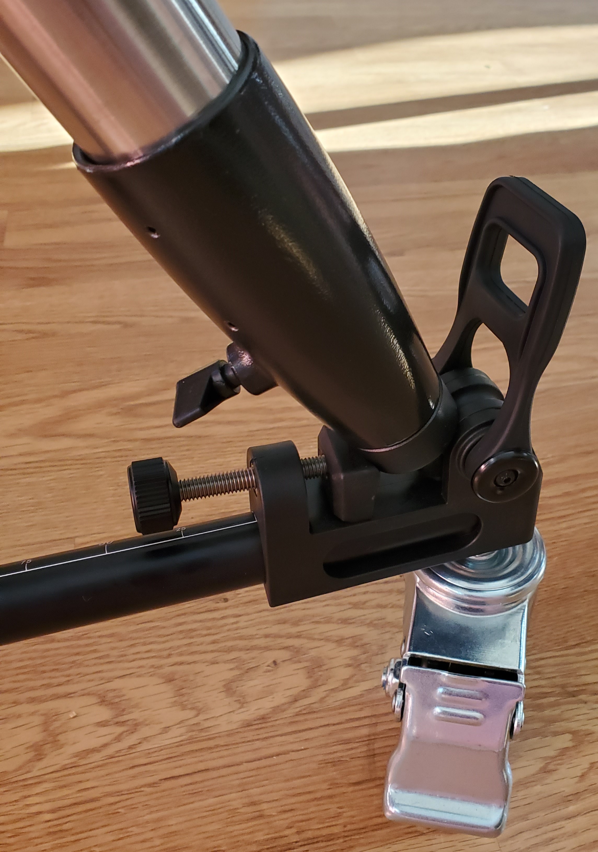

Posted 10/15/2021 08:09PM #3
One of the members suggested I look online using Amazon.  I appreciated the new focus.  I did find HTURS Photography Professional Tripod Dolly, Heavy Duty and Lightweight with 3-inch Rubber Wheels, Adjustable Leg Mounts and Bag for Canon Nikon Sony DSLR Cameras Camcorder Photo Video Lighting available on Amazon.  It was about 90.00 for the heavy duty one.  With a little creativity I think it will be very very user friendly.  SO far, I did find I need to find a way to lock the legs to the dolly, some sort of a safety strap that holds the legs directly to the dolly.  Right now it has a thumbscrew that applies pressure but does not lock the legs to the dolly.  I guess if it was easy, everyone would have done this already.  Thanks again to everyone that has offered advice.
AL
Posted 10/15/2021 08:14PM #4
I tried to add a few pics.
Big_Al_in_Jax_FL's attachment for post 183701
Posted 10/15/2021 08:14PM #5
Another pic
Big_Al_in_Jax_FL's attachment for post 183702
