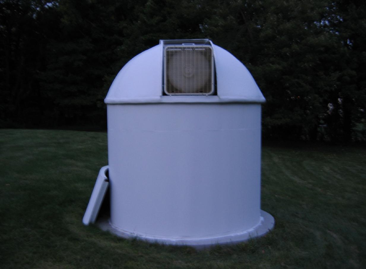

Posted 07/10/2008 04:41PM #2
Tom, on my 7' dome, the slit is just wide enough to fit my 20" box fan for observatory cooling. The slit cover has 2 pieces. The large piece I just remove and lean against the dome and the top smaller piece, I just slide up and over the top of the dome and let it rest. This size slit is the minimum to go, and I wish mine was wider, it is difficult to slew automatically with a dew shield without jamming against the opening. I usually adjust manually to get it close before hitting the goto. For some reason bees only nest on these pieces. Good luck
Regards,
Steve
fugardi's attachment for post 123525
