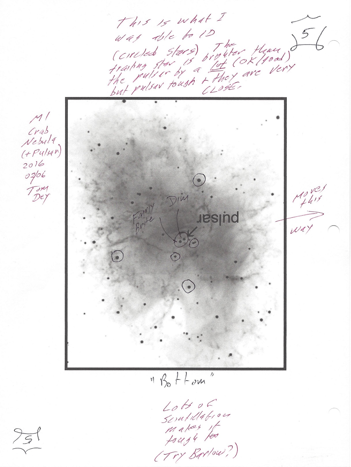

This was indeed "After Dark" last night: I have become obsessed with the Crab Pulsar and wanting to actually see it. Never had even tried before because assumed it's impossible. But I have this 29-inch Dob and the Pulsar is (ostensibly) mag (Mv) ~16; which would be just on the cusp of a scope that size. Well, Yes - I can see it, sort of: First I tried Nagler 31 107x no; then Ethos 17 196x no; then Ethos 13 256x ... maybe. By that I mean I could see something stellarish in the right place, but only fleeting with averted vision and that sort of subliminal where all I know is I could see Something there but not further describe it. And (knowing) there are actually Two stars there (the Pulsar and it's "companion"), I don't want to claim I saw the Pulsar itself as a discrete object. Next I tried the Night Vision (Micro IIE) ITT Gen3 "eyepiece." COOL! I can see the two stars! The "companion" is really pretty easy but the Pulsar is medium tough. They are quite close together, with the pulsar "leading" as they cruise across the field. I tried my visibility test for medium tough targets: Ask myself once a second for a full minute "Do I see it?" Yes, yes, yes ... , yes." So I can hold it for an entire minute without losing it = SEEN! A few technical notes: This is in agreement with my observation that Night Vision picks up 1-2 magnitudes on stars. There are other advantages (and disadvantages), but it is certailny something to consider adding to your eyepieces. I know some pureists would point out that I didn't actually SEE it, because I was cheating using the Night Vision. But, taken to its logical limit ... you'd better remove your eyeglasses before you claim you can see 10 stars in the Pleiades? Come to think of it - Galeleo cheated! Nother note: used my "Sky Quality Meter" for the 1st time. Pointing toward the "winter" constellations it reads 20.9 mag/sec^2; pointing toward the (dimmer) spring sky it reads 21.2. So regular star light actually does affect the reading! I am also pleased that my back yard sky is good - not Great ... but Good!
STOCK PICTURE ATTACHED - from my Observing Log, shows marked what I saw. Tom Dey

Update: It's been too cloudy or cold to look again, but seems the Pulsar is more like mag (Mv) 16.5 rather than 16. What puzzles me is that it should be easier to see (with this good 29-inch!) than I experienced. Now I'm thinking I may not have used enough power: The nebula itself must be washing down the stars, not unlike trying to see the central star in the Ring --- should be easy but the nebl renders it tough! Next chance, I'll go up in power --- from 256 to 416 YIKES! That's most always too much mag for resolution - but should improve the star/background contrast because the pulsar looks like a DOT ... a miniscule DOT at 256x. The only way I can get more mag with the Night Vision is to use a Barlow --- so will try that too. (The effective NV mag was a Very low 131x) Tom
