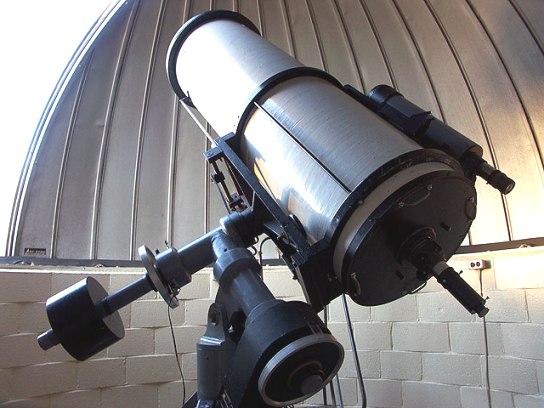

FWIW, I've observed many hundreds of DSOs using a 17" f/15 classical Cassegrain with a focal length of 6477 mm and a maximum true field of view of only 0.42 degree.
Dave Mitsky
Dave Mitsky's attachment for post 134891
