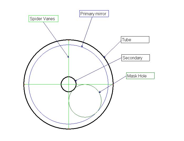

Your 10" Dob should bury ANY 90mm scope on the planets if it is cooled and collimated. Of course a lot depends on the quality of the primary mirror (and secondary mirror for that matter). If you're not an ace at collimation, learn the ins and outs of collimation. It will be cheaper than a scope purchase and more rewarding. If you are an ace at collimation already and you're still not satisfied with the Newt, try an off-axis aperture mask, i.e. make a piece of cardboard to cover your scope's aperture. Then cut a hole off to the side of about 4" diameter, maybe a little less depending on the size of your secondary mirror, and position the mask so that looking through this hole you don't see either the secondary mirror or any spider vanes. Here is a very fancy example that is made to also hold a solar filter (just forget about the filter).
http://www.teleporttelescopes.com/Access/10MasFilNew.jpg
With the mask in place, your scope is now an unobstructed, off-axis Newtonian. Technically there is a tweak you might make to the collimation from this point, but it should be darn good if the scope is in collimation without the mask.
Mike
mhosea's attachment for post 67546
