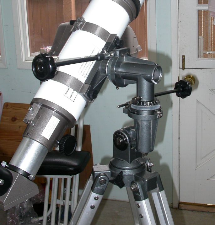

My favorite mount for short focal length 3 and 4 inch refractors is a small EQ mount with the Polar Axis pointing at the zenith. It makes a nice balanced "side-saddle mount" so it can be used like a DOB, point it and track by hand. One can also use the Slo mo controls to track smoothly at high magnifications...
The attached photo is of a 100mmF6 Achromat mounted on an Old Meade 4500 mount. It is good to 250x, currently I am using it with an ED-80.
jon
jonisaacs's attachment for post 102751
