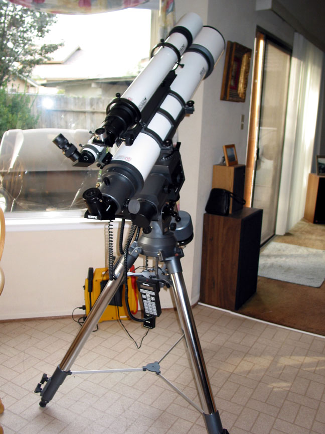

Does the scope run on 12v? If so then the 7amp battery will run most Go-To tracking systems for 4-5 hours unless it is very cold, then it will run down more quickly.
I use 12 amp batteries to run my Dob and a 17amp Jump Starter for my Refractor. I bought it at Harbor Freight on sale for about $45 and it comes with a charger. You can see it behind the scope at the wall being charged. It will run the scope for a full night and may even be able to power the auto-guider and cooling fan for the DSI II Color camera for an evening.
