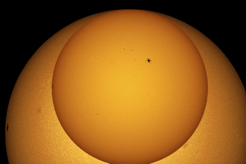

The below images illustrate the attainable image scale difference, with the foreground
Denkmeier sun using a 2x Powermate shot as a backdrop. Each was an uncropped 3072 x 2048
pixel image (re-sized down to 800 x 533 for web display).
This scope could NOT previously reach focus for imaging without relay lenses/Barlows. The
Denkmeier OCS increased back focus here by approximately 37mm.
