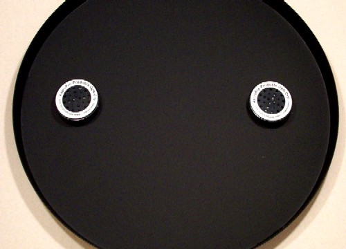

I make a product that will help you. It is designed for post viewing problems exactly as some have stated here. It can be placed inside of corrector covers, refractor covers, EP boxes, Equipment boxes etc... It holds 7 grams of dessicant. This desiccant will absorb excess moisture and help prevent spotting and fouling of the corrector. I have also included a picture of them mounted inside the corrector cover or a C14. However, they fit almost anywhere. Please see my website for more information.
Paul Atkinson
AstroProProducts
