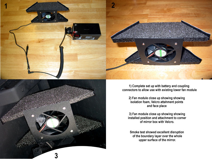

If a fan is used on the front of the mirror it will help a lot. The one on the rear won't help so much as it causes the temperature of the mirror to cool to below dew point but does only so much to help keep the upper surface free of dew.
Here is a picture of my upper fan that I make for Dobs. You can use any design that works for you.
Now some are concerned with the use of Velcro for holding the fan, so I am in the process of a new design that will not use Velcro, but uses wood screws instead.
fblue's attachment for post 95603
