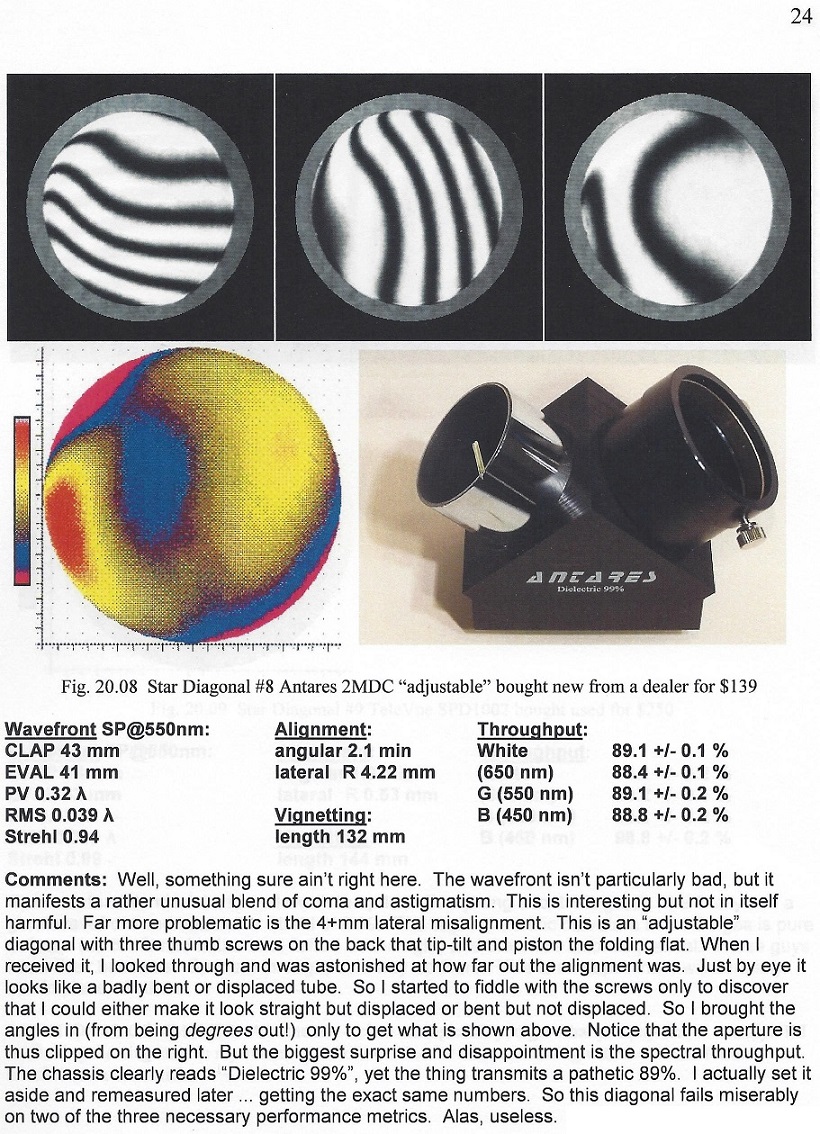

I find this place intriguing - http://www.spectrum-coatings.com/index.htm They offer standard and high-end dielectric coatings. Just getting the super R coating on the diagonal should improve telescope throughput immensely. Would want to ask regarding performance at 45 deg though; especially dielectrics need to be tuned/customized to that. I bought a New Antares 2-inch Star diagonal marked Dielectric 99% and measured it to be a pathetic 89%. All I can figure is that they put a normal-incidence coating on the thing and naively expected it would perform as a fold - NOT! Attached is an image of my Test Report on that. Tom
Thomas Dey's attachment for post 150870
