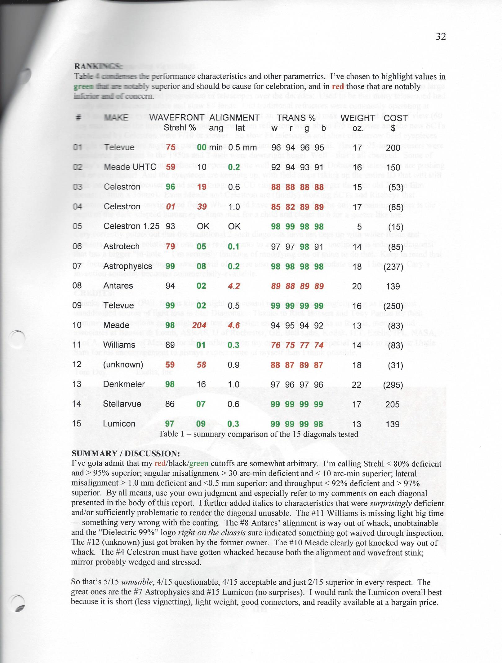

Yeah - I did an exhaustive comparative study of 15 star diagonals - measured alignment, wavefront, spectral throughput, etc. Most were deficient. Of the two Meades, one had terrible angular alignment and one had fairly low strehl (but measured over the whole diam so probably still fine when used in traditional way). Of the two TeleVues, one had a slightly low strehl and the other was very nice indeed. Here's a copy of the summary sheet. I can send anyone the entire paper if they like. If I had a web site I would put it there. Final comment - it you are doing polarization studies the dielectrics can induce phase changes that could screw up your measurements of IQUV (Stokes Parameters) or the Jones Matrix ... but Very Few here would be doing that kinda stuff! Tom
Thomas Dey's attachment for post 150077

Here's the summary sheet - Tom
Thomas Dey's attachment for post 150078
