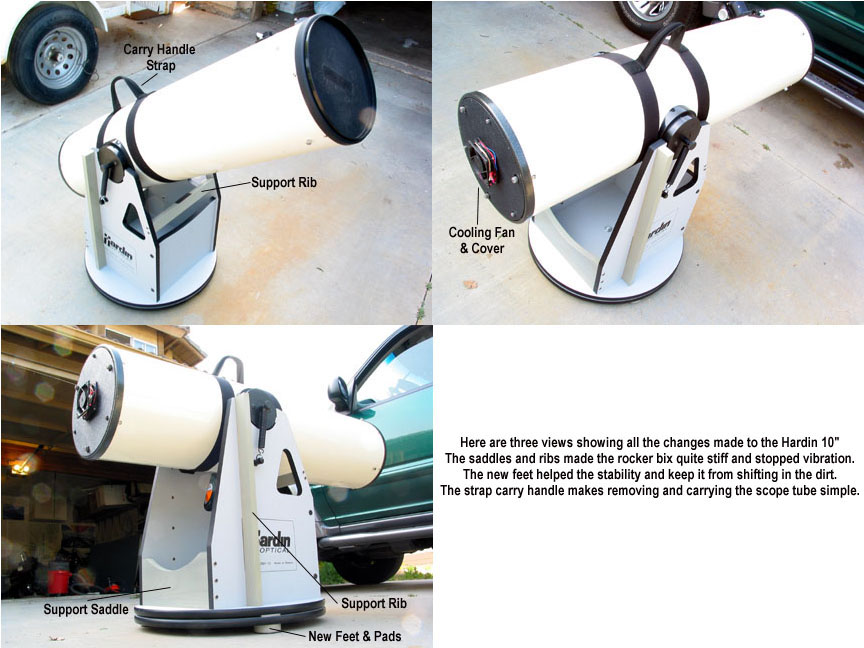

I have done the Mods to a friends 10" DSH and the bearing was removed and Teflon bearings added. Made a smoother and better moving scope.
The other mods I made can be seen in the picture.
fblue's attachment for post 92983
