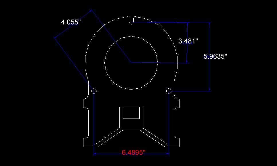

Hi all! I was hoping that someone who has any of the above scopes could give me the spacing of the 3 mounting bolt holes on the base of the scope, where the scope attaches to the wedge. I am trying to find out if any of these three would be compatible with an existing 8" LX200 permant pier mounting plate.

Drew this up awhile ago. It's the plate from a 10" wedge.
Steve
