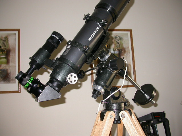

The ED-80 comes with a photo tripod block attached. Just screw it into the tripod.
I've used mine with a Bogen 3001 tripod and fluid head.
However, if you plan on high-power views of the planets, I'd humbly suggest a CG-4, astroview, or AZ-3 mount.
The photo tripod is great for low power sweeps, but you'll get frustrated quick at higher powers.

Landog's attachment for post 79150
