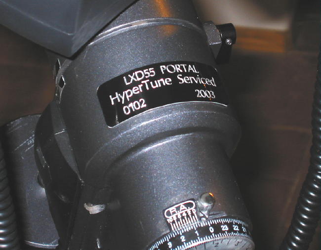

Well, as you can imagine, I'm anxious to see how things work for myself. I'm only intending to use this mount for visual use and if it's even close to what is described in the report, I will consider it money well spent. After the rains stop, I'll let you know what I find. Oh, one other thing, there is a nice little badge on the
mount (top of RA housing) that reads "LXD55 Portal, HyperTune Serviced, 0102 2003".
