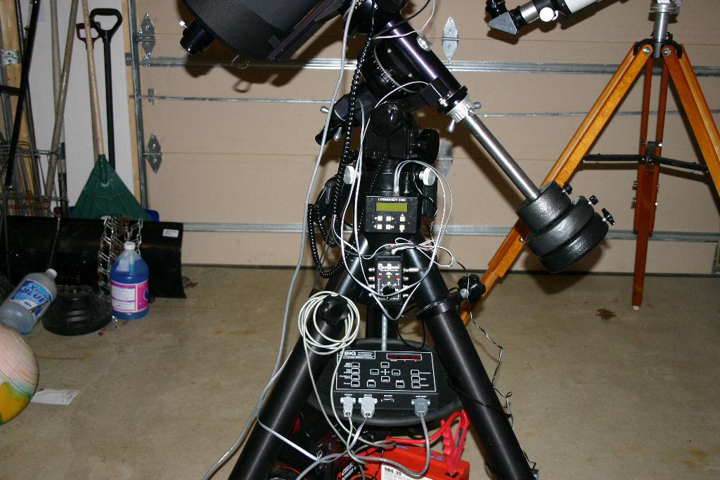

I guide my G-11 with an ST4 and an Orion 80ED piggy backed on a C9.25. The ST4 is a wonderful guider, and doesn't require a computer to operate. Perfect for film and DSLR imaging. It operates on 12VDC, which I make with a 26AH Lead Acid battery. It takes a little patience to learn, but once you have it figured out, it does a very good job.
Hope that helps. I got mine used on Amart for $450. The attached image shows the controller on an accessory shelf of my G-11, along with the DewBuster controller and the Losmandy DSC unit.
