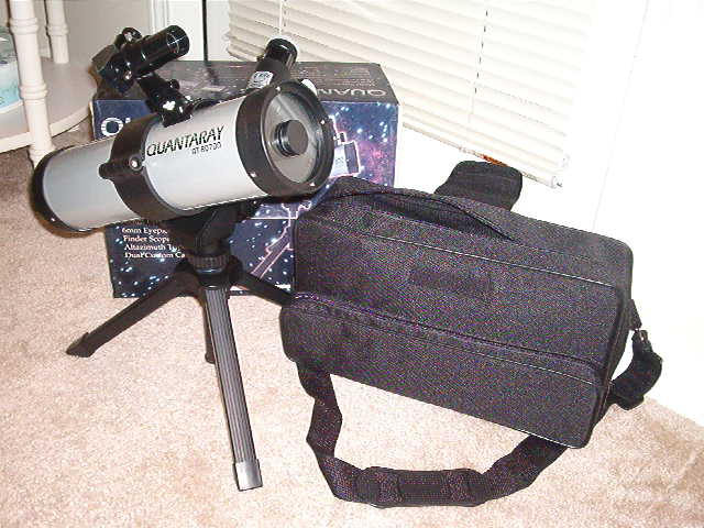

I think this tabletop scope is just a regular Newtonian reflector with some kind of corrector/barlow built into the focuser to increase the focal length. I'm really tempted to take it apart.
1) Any ideas about what can be done to improve it a bit?
2) Would it work as a short fast scope if the corrector were removed?
3) Can the mirror cell be reworked to allow collimation?
Lee_S's attachment for post 37606

Posted 06/24/2007 11:46PM #1
Lee: I have had a few of these small scopes I bought at garage sales, taking it apart is probably a good idea, particularly if you leave it apart.
"Generally" these scopes use a spherical mirror around F/4 so removing the corrector is not workable. Removing the corrector means the location of the focal plane is much closer to the secondary which means a lower profile focuser is needed.
With the spherical primary, I don't think this is so important.
Jon

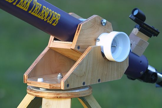

Posted 06/26/2007 06:19PM #2
For very little money and effort you could build something like the mount below for it.
It can work surprisingly well.
More pictures here:
http://www.homebuiltastronomy.com/kidpeek/index.htm
Good Luck,
rnabholz's attachment for post 114992
Rod Nabholz
