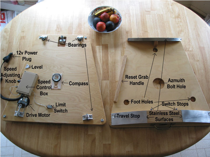

Posted 12/27/2006 05:33AM | Edited 12/27/2006 05:35AM #1
My EQ Platform is made of wood and I have two mounting methods. There is a large hole in the center where my 10" scope mounts with a plywood disk that is located with the pivot bolt through it on the ground board. The 3 feet screw off and the ground board sits on the platform with the disk inserted in the top board of the EQ Platform.
The 14.5" uses three replacement feet that are 2" long and 1" in diameter that fit 3 holes in the top of the platform and the ground board fits flush with the top of the EQ Platform.
fblue's attachment for post 110270
