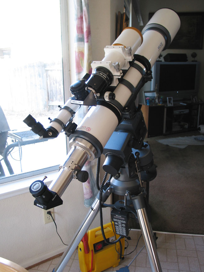

Posted 04/16/2007 05:01PM | Edited 04/16/2007 05:03PM #2
Hi Mike,
I have the LXD650 mount and it is pretty nice. The Go-To is accurate, the slewing is fast with a bit of noise. It is very stout and the tripod is steady and strong.
I did have to adjust both drive worms for lash and re lubricate the gears. There was binding and a lot of noise, but after adjustment the noise was abated and no binding.
I have the 127ED with an 80mm EO APO that I use together on this mount. The load is probably about 28-30lb. It handles the load just fine, but I did need extra counter weight. I bought 7lb and 4lb weights here on Astromart used, and drilled the centers to the proper size for the shaft. They were Orion weights I believe.
The weight limit is listed at 30lb I believe, but it is probably very conservative for visual use.
fblue's attachment for post 113301
