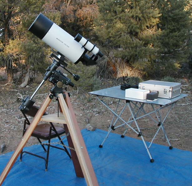

Posted 10/25/2003 05:23PM #1
The MK 67 Deluxe will perform much better than the 6" achromat refractor - you will not have chromatic abberation, which degrades the images of the refractor more than the contrast lost from the central obstruction of the Maksutov.
I also bought an MK 67 from ITE (took almost 7 months do be delivered, partly due to the US west coast dock strike of late 2002 - ouch...the wait was worth every day) superb optics, pinpoint stars, great planetary & lunar views.
I suggest buying a premium 2" diagonal, & add a Telrad unless you are going to use a GOTO mount...the 10 X 50 finder scope has a fairly narrow field of view (I use the Telrad to get close to dim objects, and use the finder to center the scope.
The scope does take a while to temperature stabilize, but the views are worth the wait.
Additionally, I had a very good experience with ITE...Bill answered all of my questions, and was a peasure to do business with.
