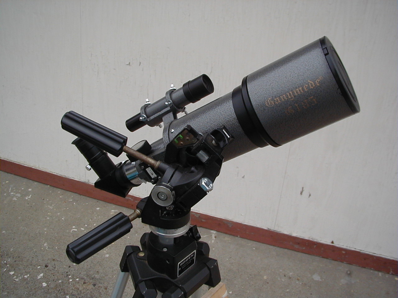

Posted 12/24/2003 12:10AM #2
Did you try mounting that C-102 "Side Saddle" on that 3047 head? Normally a photo head like the 3047 with a scope on top will become unbalances as the scope altitude increases. However by mounting the scope alongside the head by flipping the top axis 90 degrees, it now functions as a balanced mount because the axis of rotation can pass through the center of the balance.
I use this scheme with my Pronto and I find it works very well. The Pronto is probably actually heavier than the 102 F5. Worth a try before investing in something else.
The photo is of a short tube 80 mounted "Side saddle."
jonisaacs's attachment for post 74416
