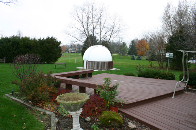

Hi Mike, you are a neighbor part of my time. I am in Pt Charlotte during the winter. I have a 10' ProDome from TI (Home Dome) here in Indianapolis. I recently talked to Jerry Smith of TI and he tells me that the domes have been certified for Florida hurricane weather as stand-alone structures. Probably by now it is ceritified as okay as a part of another structure like your house.
If I were you, I would check their web site and get the literature that discusses adding the dome to another suructure. They have tried it all. Their web site is http://www.homedome.com/
I put mine up as a stand-alone structure in 2002, and it is a wonderful addition to my hobby. BTW the attached picture was taken last fall just before I left for Florida.
With regards,
Ted
tvansickle's attachment for post 91940
