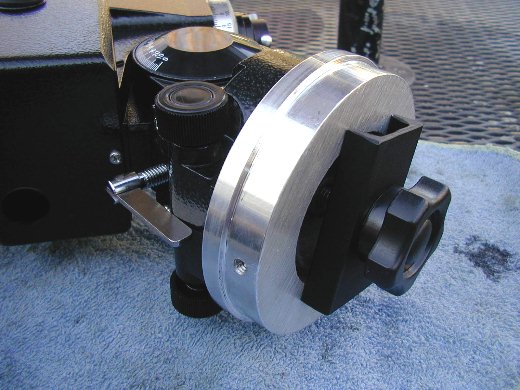

I'm considering installing a piece of heavy 4" galvanized pipe in my front yard as a pier. I'll probably build a small deck around it but this pipe is heavy and set into a concrete base will be mighty secure. What I need is an adapter to fix the CG5 to the top of the pipe. I can fix a plate to the top of the pipe but would like to buy something off the shelf rather than spend lots of money at a machine shop.
Anyone know of a source?

I believe this will do what you want. Another Astromart Supporter too http://www.kendauzat.net/other.htm
David W's attachment for post 92465
