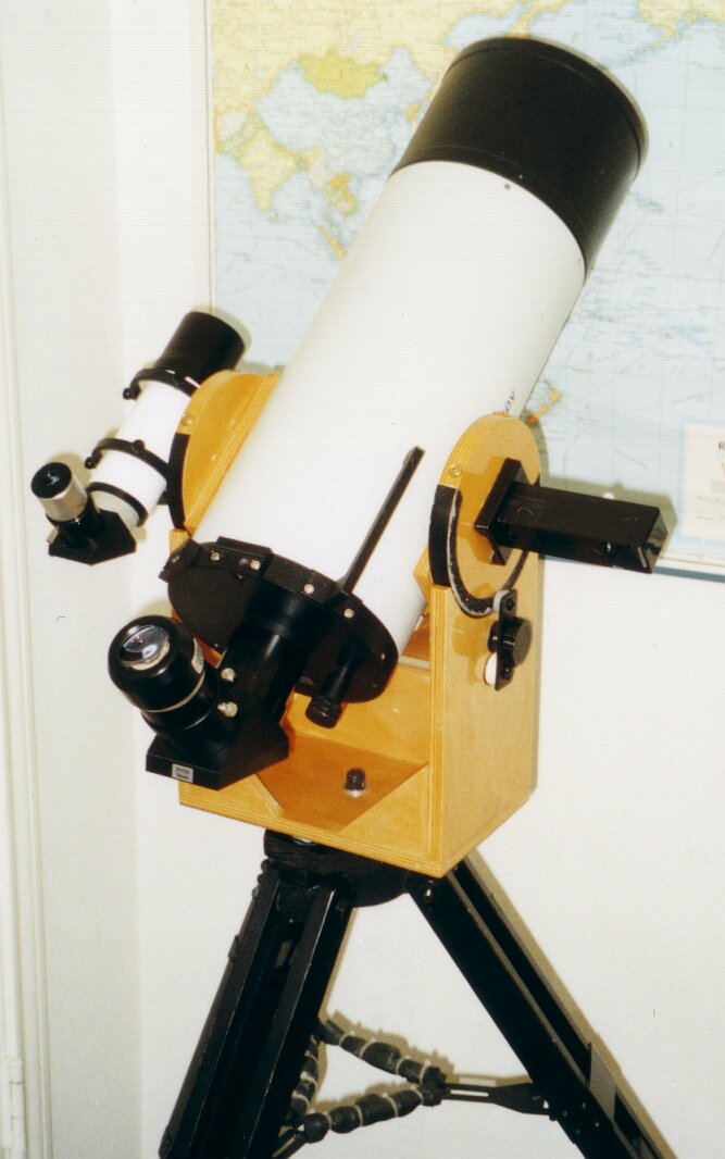

Now it seems like the AZ3 mount ought to work for that little scope. I had a Celestron version of that mount that gave fabulous stability with a Tele Vue Ranger.
That mount wasn't good enough for the Intes MK-66 Deluxe, and it was this that sucked me into ATM-ing. TThe telescope and mount are sold now, but you can see what I did for the MK-66 in the photo below.
Mike
