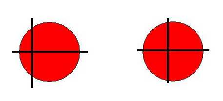

I recently purchased a Nexstar 80GT (80mm f/5 refractor) and was very dissapointed with the views I was getting. I could barely get Jupiter to focus at 50x, it looked like a very fuzzy ball and the 2 brightest cloud bands were not visible at all, stars also looked really fuzzy. I also noticed that I was getting much sharper images using my 45 degree correct image diagonal...wierd. I put a cheshire eyepiece into the star diagonal and immediately discovered the problem (see left circle in the image below to see what I mean). I figured the diagonal was completely screwed up so I took it apart. The mirror was definitely glued in crooked with rubber cement which I removed pretty easily. I put it back together and put the cheshire back in (see the right circle in the image below) what a difference. I went back outside to look at Jupiter and I could see a 200% improvement, disk was sharp and cloud bands were bright. I knew the image could probably be even better if I got everything perfectly centered in the cheshire so I took the diagonal apart again, put 2 small strips of double sided tape on the back of the mirror, stuck it in place, put the diagonal back together and stuck the cheshire in....everything looks perfectly centered now (how is that for luck?). Unfortunately I'm too tired to take it back outside and see if my final tweak made a difference. I can't wait to test it tomorrow and see if I can actually push this scope up to 100x.

dreamsofarafel's attachment for post 14522

This is a common problem in my experience. I have had 3 Chinese 1.25 inch Chinese Star diagonals in the past 4 years and each has suffered from this problem. I use a laser collimator to check the alignment.
I recommend that anyone with a Chinese diagaonal take the time to make sure it is properly aligned.
The technique I use to refasten the diagonal is to just use a thin layer of silicone glue between the back of the mirror and the plastic back plate. This seems to provide "perfect" alignment.
