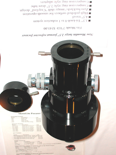

how about the new 2.5" dual rate Moonlight focuser, designed for APM ?
Markus
apmtelescopes's attachment for post 90999
clear skies
Markus Ludes
APM-Telescopes/Germany
