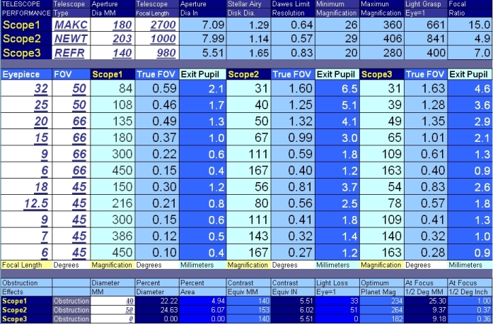

Hi All,
This is updated version of a scope calculator I posted sometime ago. I know there have been many shareware/freeware programs for calculating the performance parameters for telescopes and eyepieces but I never found one that gave me all the info I wanted and many did not have the ability to print. This is a simple spreadsheet but with it you can get general information on what to expect in telescope/eyepiece performance. Many of us own more than one scope and many eyepieces. We can sometimes scratch our heads trying to remember what magnification we are running on the scope we are using (ever been asked that question at a star party?). You can print the spreadsheet for use as reference at the scope or use it in your laptop while observing. I find that I use it quite often when doing scope comparos.
It was made using Excel. Since we can only post images here, if you want the spreadsheet just drop me a line at [email protected] and I will be happy to send it to you. If you like it and think someone else can use it please feel free to "spread" it around (Pun intended).
As you can see in the screen shot there is some useful info. All the white areas are for data entry. Put in your own telescopes, eyepieces and obstructions. Those of you who are comfortable with spreadsheets, you can edit anything in it to suit your needs including the simple formulas, colors, fonts, etc. I have added a performance area that deals with secondary obstructions. Beginners please note that the contrast factor (aperture equivalent) is not the same as light grasp. As an example the spread sheet shows that a 180mm F/15 Maksutov with a 25% obstruction is equal to a 140mm APO in contrast (both scopes are optically excellent) but the Maksutov will have higher resolution as well as higher magnification potential and greater light grasp. You can also "run the numbers" to see if upgrading your old scope to a new one is worth it (like going from a 8" telescope to a 9" telescope).
Also, please do not flame me about the calculation concerning optimum planetary magnification. I know that we can run more under good seeing conditions with a given instrument. The number represents the best "general visual acuity limit" (.75mm exit pupil). I'm posting this for anyone who could use this kind of info other than me smile
Keith
