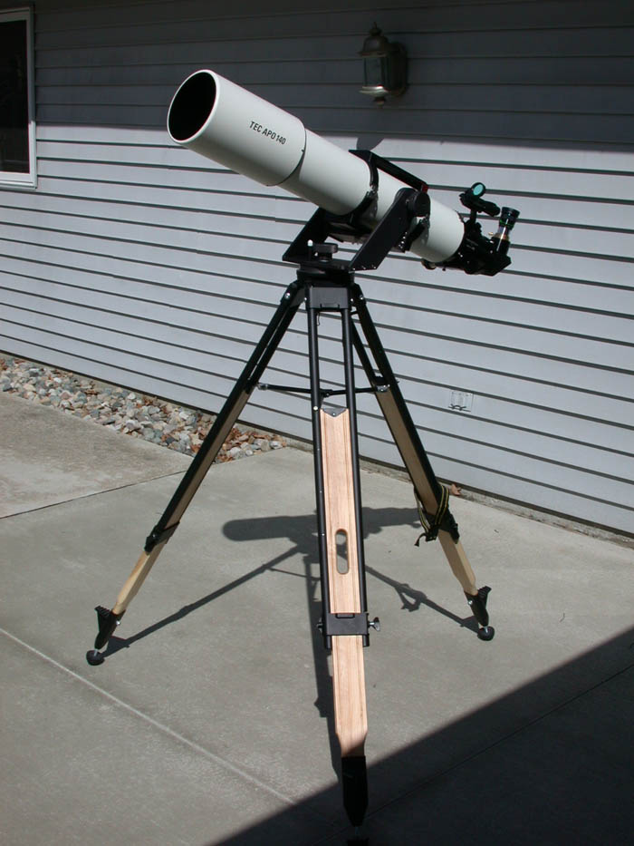

I've heard very good things about the stability and smoothness of a Discmount...but you pay for what you get. This is a snap of my TEC 140 (#70) and its UA Unistar Deluxe with Argo Navis DSCs, another viable choice in the race for a good alt/az mount. Good luck!
Walter

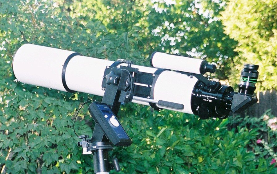

I had the Universal Astronomics UniStar and like it very much, but wanted a cradle type mount. I purchased an 8" Helix Hercules cradle mount and like it too. The Hercules is about the same as the UniStar when it comes to being solid. Early this morning I was tracking Jupiter at 326x without any issues. So Many choices....
