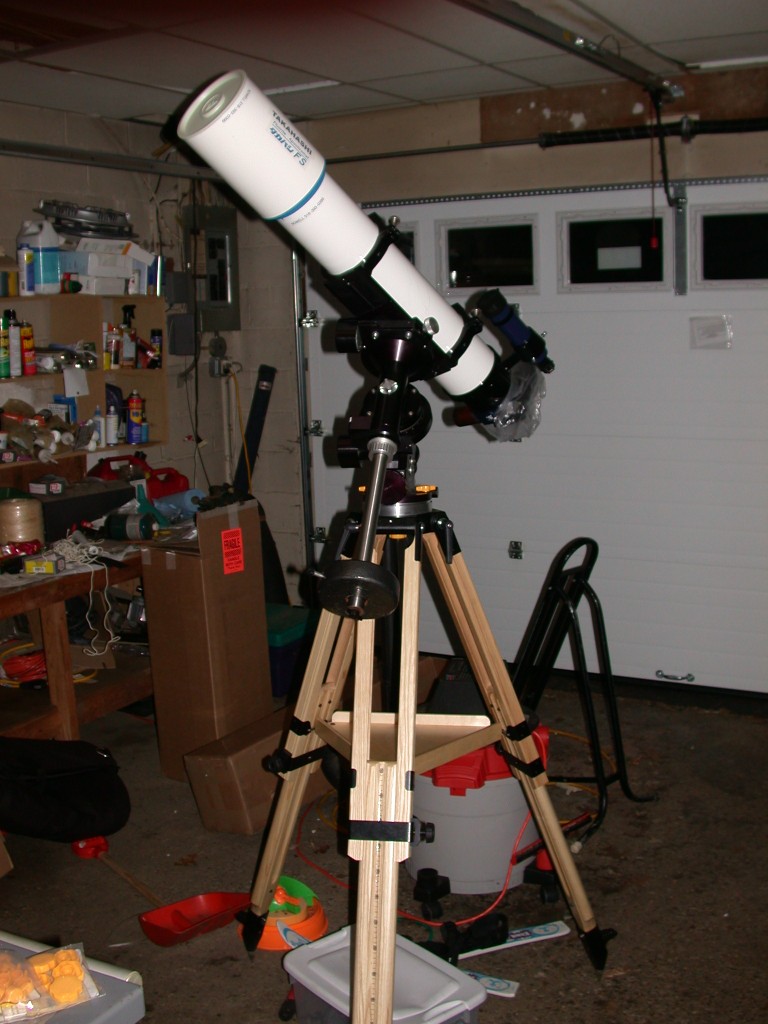

Hmmm. Well, there are some wires. The thing is, most of the wires I have I would have on any mount. Most of what you see dangling are the power supply, running from the battery up to the side of the mount, and dew control technology for the tube; and the Argo Navis computer. A different type of mount would deal with some of these wires but by no means all of them. For example the dew control runs a wire from the power supply to the control box, and from there I have two wires going up to the tube; a third wire is going down into the eyepiece box where I also run a heater.
A CGE would relieve me of the Argo Navis (and its wires) but so would the Gemini unit for the G11. It would remove two wires from the G11 control panel, if memory serves, the ones you plug into the RA and Dec motors. That's about it. It would be nice not to have wires but the main thing is most of them are not due to the mount. I'll take the wires and push-to over go-to because even though I have wires I have less system complexity and higher gearing in the steppers. For me that works out better.
I also have an AP900QMD era. You don't hear anyone accusing AP900s of having too many wires but they have the same as a G11. You didn't say if you want to take pictures or not. But at any rate for a 5 inch refractor you should do fine with a G11 even if you DO photography.
Incidentally after I bought the AP900 I kept the G11. I have it on a wood tripod (berlebach) and use my 5 inch refractor on it. So I think the wire thing with G11s is overblown. A long thread on Yahoo! Losmandy has been unfolding on just this topic so you're welcome to join and read the archives.
Greg N

I've got a picture of the FS128 on the G11 with wood tripod here (in my cluttered garage) and it doesn't have the wires, but then, I already posted wires. I was just setting it up to see how it balanced.
gnowell's attachment for post 117343
