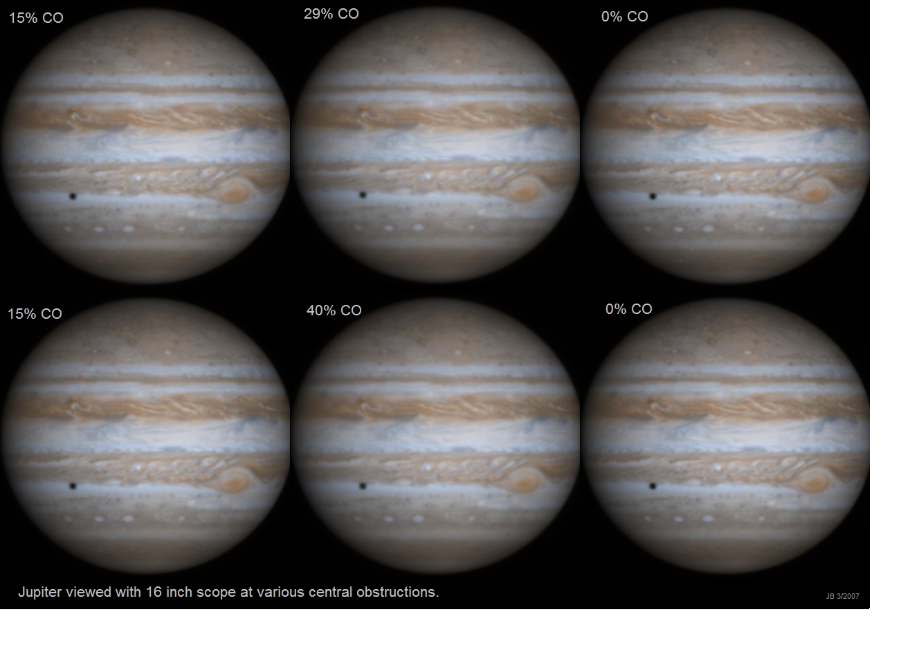

I've boiled it down to two choices: a 16" f/8.4 RC (optics likely by Star Instruments), or a 16" f/14 classical Cassegrain (Tak C-400). I already find the field of my 16" f/10 SCT somewhat limiting, so I'd probably use the classical Cassegrain with a focal reducer (yeilding f/10.4).
The RC would still have a considerably shorter focal length, which is enticing. But the classical Cassegrain has a smaller central obstruction (29% vs 40%). The RC optics makers have suggested to me that the CO size will not be an issue for my intended application, even visually. I've heard others say the CO size is very important. So where's the truth?
