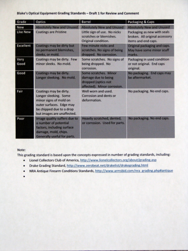

Posted 08/28/2010 06:59PM | Edited 08/28/2010 07:42PM #3
Thanks for your replies. I have attached a proposal to this post for forum consideration.
A few thoughts regarding the replies.
- No worries about the example. I've dealt professionally with these kinds of differences in the past.
- I'm also not worried about "enforcement", as the rating scale provided by AstroMart takes care of that.
- My hope for such a guide is that it will help proactively narrow the gap between our interpretations of what these terms mean, resulting in fewer item returns and renegotiations (hopefully the only ones that lose are the shipping companies due to fewer returned items!)
With that said, here for your reading and commenting pleasure is my proposed standard. I've taken the concepts from a number of other hobby standards that I'm familier with, including Toy Trains, Firearms, and Ham Radio.
(jpg of the document is finally attached)
A few thoughts about the guideline: My goal was to remove as much subjectivity as possible. So, I've chosen to avoid the use of percentages. I've also attempted to make the criteria as "yes/no" as possible. Also, limiting the number of grades to 7 +/- 2 seems to make a lot of sense (preferably erring on fewer) as the more grades there are the more difficult it becomes to pick between two grades (6 or 7 grades seems optimal based upon other conventions I am familiar with).
Thanks & Regards,
Blake
baandrew2000@gmail.com's attachment for post 138191
