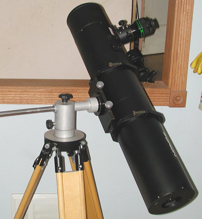

I use my Maks on a Giro Alt-Az mount. Attached is a photo of my MN61 Mak Newt on a Giro. It's important to use a rock solid tripod with the Giro. I also have a MK67 MCT which I use with the Giro. When the Giro is mounted atop a Bogen 3036, it's unsatisfactory at high power. But mounted atop the surveyor's tripod shown in the photo, it's very stable no matter the power.

I use my MN66 on a Unistar Heavy Deluxe alt/az mounted on the tripod for my (now former) Atlas mount. Works really well, and it only weighs about 8 lbs., is rock steady and no counterweight needed. I also like the Giro for its slightly more compact design. They are both about the same price, and you can't go wrong either way. FWIW, I am now searching for a suitable surveyor's tripod as I just sold the Atlas mount.
