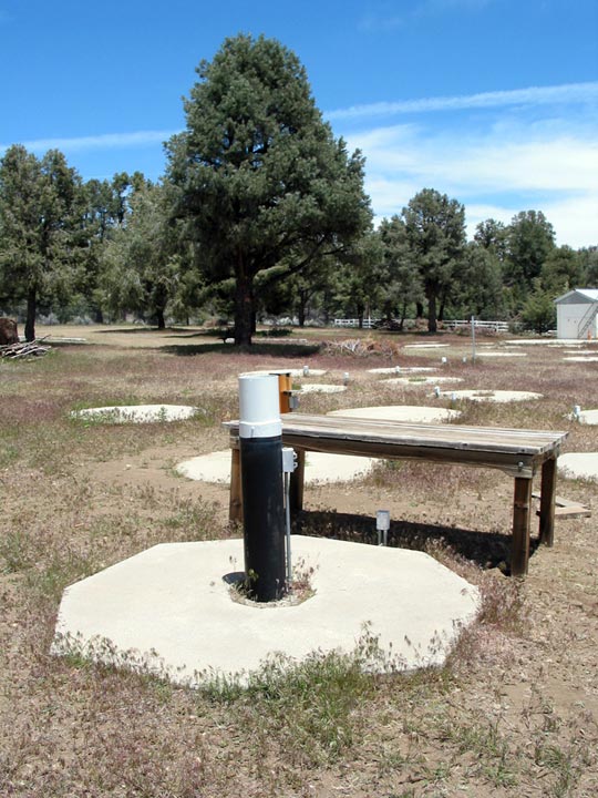

This first shot shows how the pads are setup in the LAAS site. I have a table there to place stuff when setting up and it keeps stuff off the ground. You can see the pier has a electrical box with two outlets and two more are at the side of the pad. The pad is about 7' across.
fblue's attachment for post 51073

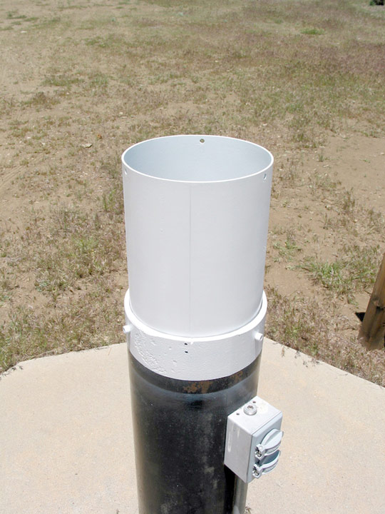

This shot shows a close up of the insert pipe and how it was done. Now the pier is 45" tall and that should work fine for imaging.
fblue's attachment for post 137151
