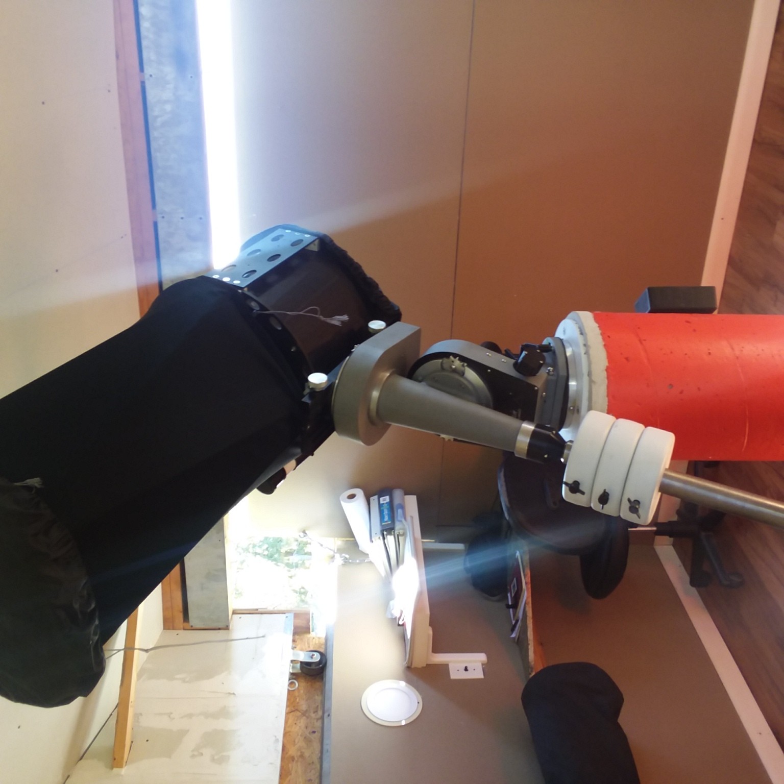

Whew! I spent four years and nine months "getting ready", but I finally upgraded.  I saw an MI-250 for sale and jumped.  I bought it in September 2019, and installed it about a month later in October.  It took me a while to figure out how to adapt my concrete pier to MI-250, figure out contingency plans in case Plan A failed, and get mounting plates cut and drilled.
The MI-250 is a pretty big step up from the G-11 I was using.  I took the mount almost completely apart for cleaning and regreasing.  I did not disturb the mount for the worms: they looked like they were set carefully and precisely to ensure the worms are tangent to the worm wheels and I don't have the instruments necessary to repeat that.  Everything else went well, though.
The MI-250 moves with silky smoothness.  I had to spend much more time precisely balancing everything to get it stable when the clutches are disengaged.  It has much less static friction than my G-11 does.  I even had a ask a friend to make me a counter weight to balance my finder scope.
For visual observing, Gemini II is a pain in the butt.  I took the Gemini I included with the MI-250 and put it on the G-11 I am keeping as my travel mount.  The Gemini II I had on that G-11 is now on my MI-250, permanently mounted in my observatory.  At least I won't have to build pointing models with Gemini II often.
As Greg Schaffer recommended in a previous post, I've got far less than 100 pounds on my mount.  The sixty or so pounds I have (plus equal counter weights) was a strain for my G-11, but my MI-250 doesn't seem to mind at all.  Slew speeds are 65% faster.  Tracking is plenty good enough for visual, of course.  The scope I have in my observatory is no beginner's astrophotography scope (5250mm focal length), so it will be a while before I know if it's a good mount for imaging.
My only gripe about the MI-250 is the adjustments for altitude and azimuth are poor, making polar alignment frustrating.  Oh, and the bubble level is off...

Posted 02/14/2020 09:16AM | Edited 02/14/2020 09:17AM #6
Installation day (odd, the photo is right-way-'round on my computer...):
macdonjh's attachment for post 166449
