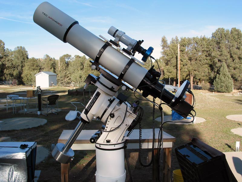

Hi Kelly,
If you use 8" Schedule 10 (as I recall) pipe, then the regular pier adapter for the AP-900 will slip right in, it is the same size as the portable pier. Then all you need is the holes drilled to screw to the pier adapter.
Here is mine on a piece of this pipe, with holes drilled. The upper piece of pipe is the 8" and then it is slipped into a 9" thick wall pipe with 1/2" walls and drilled and bolted. But you could make the pier with just the 8" Schedule 10 pipe in a hole with concrete foot.
fblue's attachment for post 144161
