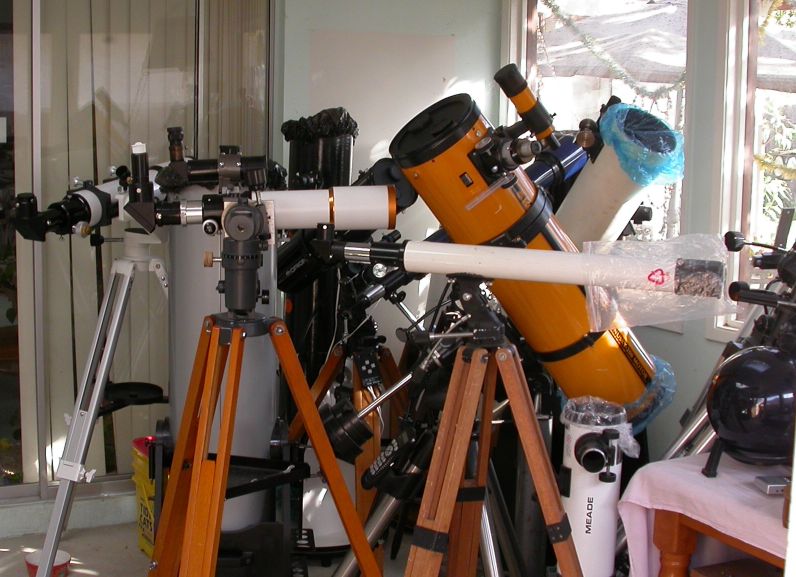

I have some experience with the scopes you mention as well as quite a few others. I do have an 8 inch F/5 Newtonian on a Celestron CG-5 ASGT mount as well as various smaller and larger DOBs and EQ mounted Newtonians etc...
A few thoughts/opinions:
- For visual work, I would go with the 8 inch F/5 standard Newtonian over the SN. The 8 inch SN has a 38% CO vs a ~25% for the CN8. It is also F/4 rather than F/5 which makes it tough on eyepieces, I think F/4 to be avoided unless there is good reason to choose it specifically. The corrector leads to slower cooling.
- Given the choice between the 8 inch F/5 on the GEM and 10 inch F/5 DOB, most nights I will choose the DOB. It is easier to setup and the 2 inches of aperture more than makes up for the lack of motorized tracking. If I am driving to the mountains for an long evening, it is often my choice over not only the 8 inch F/5 but other larger scopes like a 12.5 inch F/4.06 and a 16 inch F/4.42, both Truss/Strut Dobs.
The 10 inch OTA is 48 inches long and weighs about 35lbs. It fits across the backseat of any car I have owned including an old Nissan Sentra.
So that's my two cents, based partially on opinion but with a lot time at the eyepiece included.
I think you can see the 10 inch DOB and the 8 inch F/5 in this photo...
