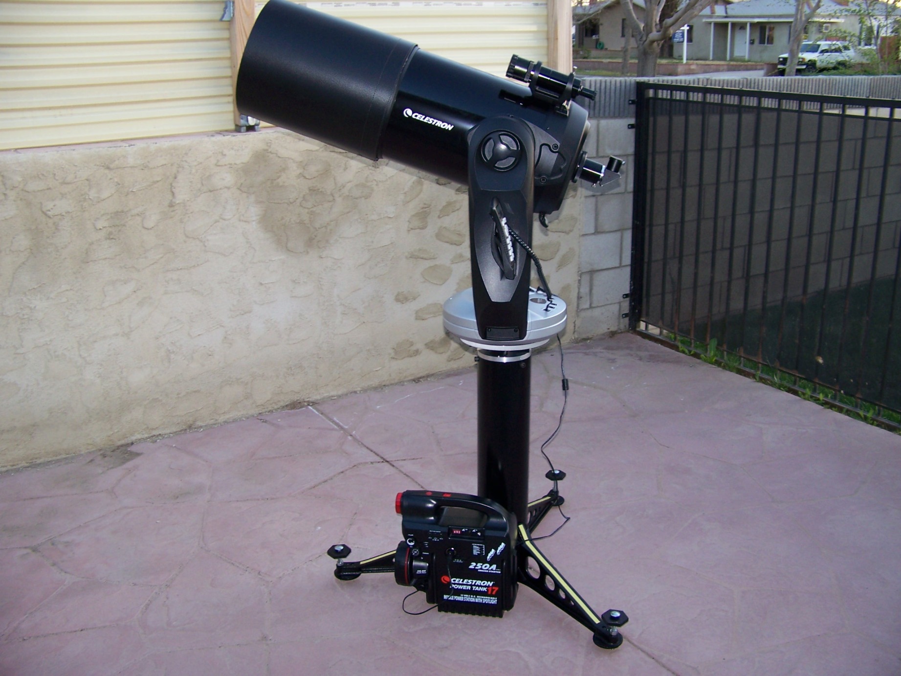

Posted 07/23/2009 03:18AM | Edited 07/23/2009 06:28AM #3
I don't claim to be an expert, experienced maybe but no expert. I have not had the pleasure of using an NS but my CPC-1100 is excellent both mechanically and optically. If I had to rate the optics compared to the five C-11s I have owned this current system would tie at the top with an Ultima I rebuilt some years ago. A 250 line grating at 3 bands (outside focus) are straight and well defined with a clean edge. Out of focus patterns are very close to identical and on nights of good seeing the airy disk is well defined and of "textbook" quality.
I don't know if the optics were made in America but the Bob's Knobs I installed were metric. GOTO's are incredibly good. Tracking is superb.
Lunar/Planetary views are very good as long as the scope is cooled to ambient temperature and well collimated.
Hope this helps.
Keith
klawson's attachment for post 131492
