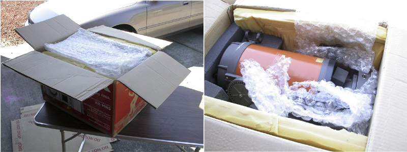

Posted 12/01/2004 05:49AM | Edited 12/01/2004 05:51AM #2
Hi Dave,
I received a vintage C8 scope a few months back, and it was packed in thick soft foam. It seemed to survive the trip just fine. Here is a picture of some of the packing.
Also, here is a picture of how I packed a C11 scope. The end packing material is thick, firm, "Ethafoam". I used two thick layers. It is some of the best packing foam there is.
David Simons
(C8 pictures below)
David Simons's attachment for post 85477
