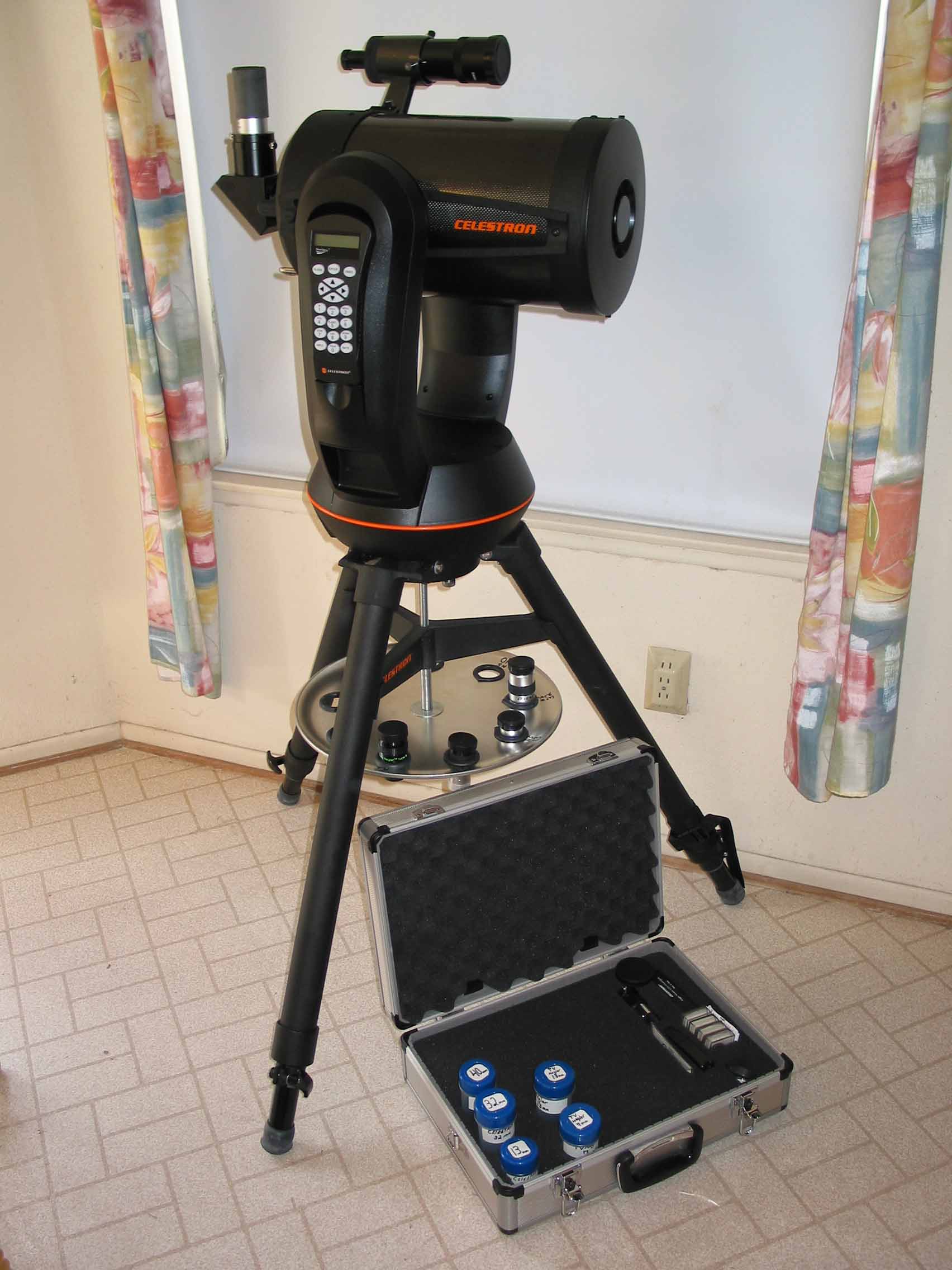

I owned one of those, the NS8GPS, it was a very nice scope.
Are you using a diagonal when it does not reach focus? What eye pieces were used?
The moving of the image is due to mirror flop. The primary mirror is moved up and down to achieve focus. It slides one a tube which is lubed with grease. As it moves it can also move side to side slightly, which causes the image shift.
Try adjusting the focus all the way in and out a few times to spread the grease on the tube, this is know to help.
fblue's attachment for post 123818
