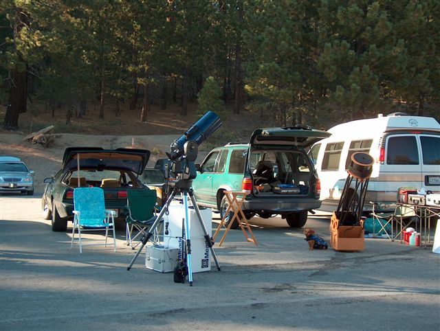

I would agree with what has been said so far. I have 3" and 5" refractors, 10" and 14.5" Dobsonians and they are totally different animals.
The refractor has its good points, it has a nice crisp look and will do quite well with double stars, planets, Moon and such. The Dob will work for this and for the dimmer objects, like galaxies and nebula.
I would say a 10'12" Dob would be a great start. Get one with a good mirror, buy a second hand one and then you can get a quality scope for your budget.
This is a shot of my 10". It is small enough to fit in most cars and yet has a very good view on most any object.
My guard dog is on the watch, so it is safe!
