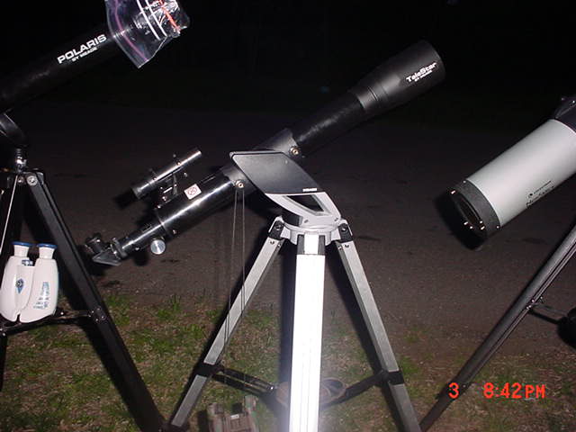

I bought a couple of meade scopes and they had .965 eyepeices. They were ok. I spent the money and got adaptors so we could use 1.25 peices. By doing this the views are much beter. give it a try.
