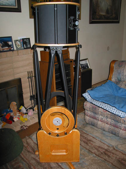

Although I know there are always trade-offs, I decided to build a 12.5" dobsonian that will be used for visual use and CCD photography. I plan on getting a Tom O. platform for tracking the sky. I will probably go with a ST-2000XM for a camera (if I can scrape together the funds).
I've ordered a very good mirror and plan on investing in an excellent cell and focuser. I expect to design this dob a bit heavier and more stable than most.
The question is-- Is there any general design guidance any of you can offer? For instance, I'm not sure if I should go with a very rigid truss or minimal secondary support (to reduce wind resistance). Would it be wise for me to build in a way to 'lock' the position of the dob? etc, etc...
Thanks for you time.

If you want to do photos, make it stiff and rigid. The more solid the more stable and less vibration.
This is my 12.5" DOB, it is pretty steady. I think that bigger alt bearings would hav been better though, I have a little vibration when you hit the upper cage, but it dampens put quickly.
Floyd
