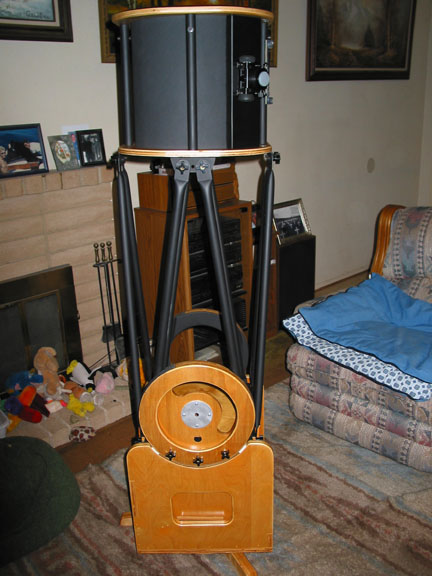

The 1.25" will be great, a little heavier, but very stable. You could cut some decorative holes if you wish to lose a little weight. This 12.5" had 1.25" sides and there were cut outs to lighten it.
fblue's attachment for post 106891
