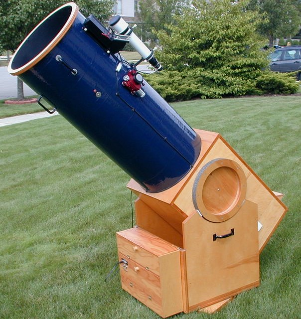

Posted 10/08/2004 11:47AM
| Edited 10/08/2004 12:49PM
#2
Hi, Ed, a misconception is that Sonotube(tm) (the "real" Sonotube brand I mean, don't know about QwickTubes) is simply cardboard. It's fibers are made and treated to resist moisture, since it's original purpose in life is for casting concrete pillars. I've used Sonotubes for my scopes for years and if properly sealed and finished, they make a very sturdy and durable telescope. The tube on my 13" dates back to 1997, and has seen some extremely heavy dew and shows absolutely no signs of deterioration (see pic). They do tend to be a little on the heavy side, but when you consider the price they're quite a bargain.
Here's a link to more info: http://www.concreteacc.com/sonotube.asp
I'm not sure what you mean about "attachment points and overall fit". If you're worried about a perceived lack of precision re: mounting holes and such, I've never had problems with any of my Sonotube scopes not holding collimation. And sorry, I don't know about "Hollow tube" either. Gee, I guess I didn't answer your question did I?
