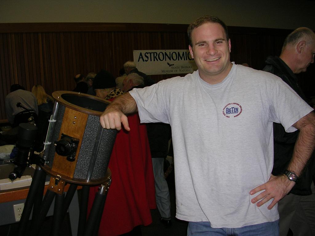

Here is a close up of the upper cage and the proud owner. There are a few other interesting things to see (the circular spider, the stowed configuration, etc.) but I don't have photos of them now. I'll try to get them tomorrow night.

Nice job. I really like the clamp idea.
