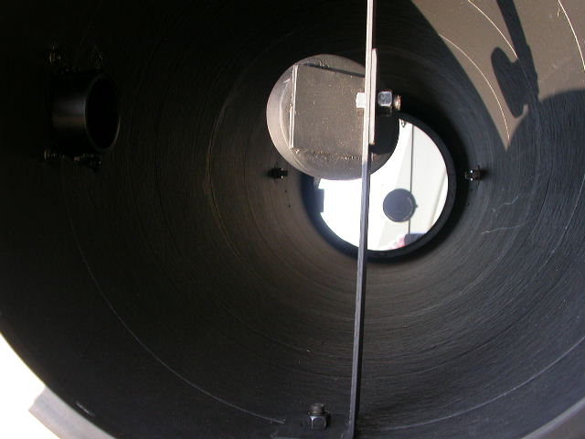

I have a Coulter 3.1" Secondary Mirror on its origional mount. It appears to be contact cement with a fiberglass cloth in between. The mirror is in excellent condition except for this big piece of angle steel hanging off it back. Thanks

I found a picture. Now you will be able to see what I have to work with.

Posted 06/16/2008 01:42PM #4
I did it! I used a coping saw with a fine tooth metal saw blade. Tried a utility knife, wouldn't cut it. It took about two hours of slow work but well worth it. Thanks to all ans clear skies
