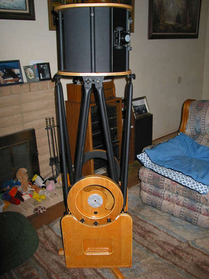

A 12" F/5 would be great, they are a nice size and will perform well. Here is a picture of my 12.5" f/4.8 for starters. It is a simple design and not too heavy. IT weighs in at about 65#.
Floyd
fblue's attachment for post 83492
