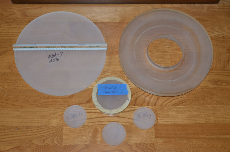

Doesn't seem to be much interest in this but I'll give it another try and show some glass grin
I set this project aside a few years ago to work on building Sierra Chaparral Observatory.
Attached is an image of the glass nearly ready for finishing. The 12.6" fused silica primary is complete. The fused silica secondary is generated. The Schmidt corrector is NBK7 and the lens elements are shop friendly crown and flint, nothing exotic here. All are ready for fine grinding.
