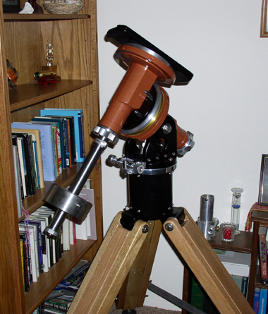

Let's try a different forum. Has anybody out there tried a ServoCAT on a German equatorial mount? I'm about to dive into this, but even Gary Myers at StellarCAT isn't sure how well it will work. Been building the mount (picture) since April. I would like to make contact with someone who might help me avoid reinventing the wheel.

Nice looking mount Steve. You do the machinist art proud 8)

Back from powder coating. Still no feedback from anyone who has used ServoCAT ona GEM. I know I'm going to be pretenting I live on the equator, and I'll have to re-set the RA drive direction every time I "flip" over the meridian, but I can still get a smooth goto, right? Having just sent StellarCAT a large amount of money for this experiment, I'd like some reassurance from some ATM. Getting kinda nervous, you know?

Still looking for someone with experience in this matter. Now the mount is back from powder coating, and I'm waiting on some bronze bushings to mount the worms. Motor and worm mounts in progress -- should be done by April!!!
